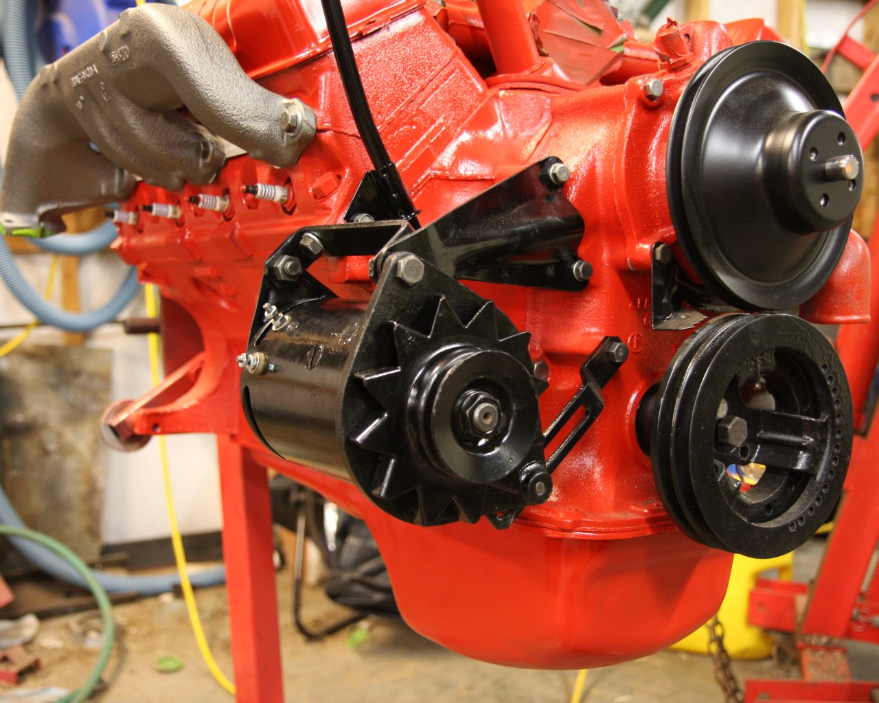

I installed the correct bearing block for the generator and got it mounted.

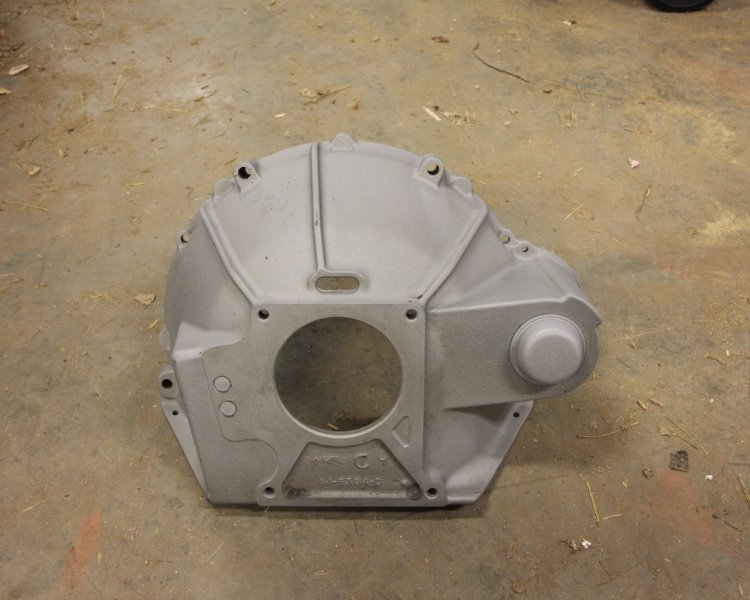

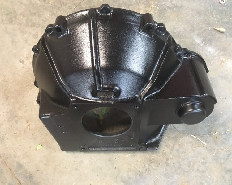

Had the clutch housing sandblasted and then I painted it.

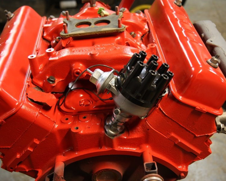

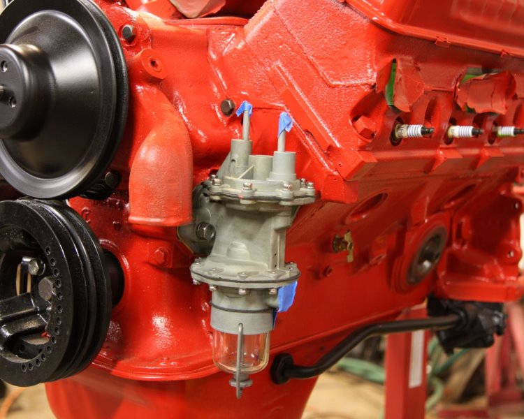

Mounted the fuel pump.
and distributor.

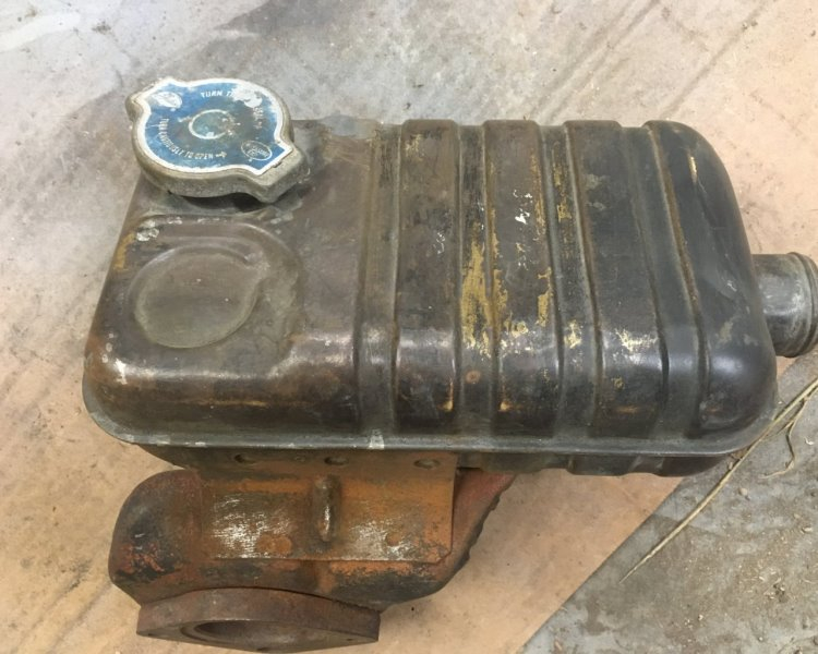

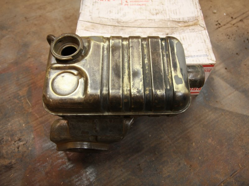

Working on surge tank next.

everything is looking amazing. I know its not factory correct but I have seen where a lot of guys strip the paint off of the serge tank, polish them protect them with a clear coat. They look really sharp that way

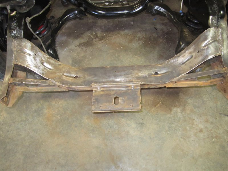

Received left front suspension parts from the sandblaster and powder coater.

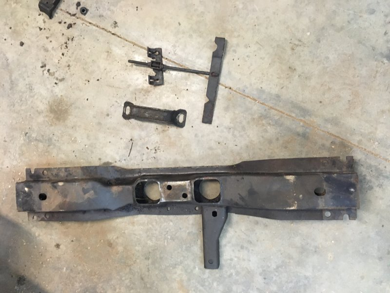

Sending out transmission mount to be sand blasted.

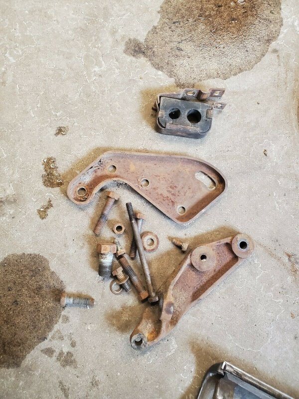

Also, finally found some Y block power steering mounting brackets. A big thanks to Windy Hill Auto Parts in New London MN. Sending them to the sandblaster too.

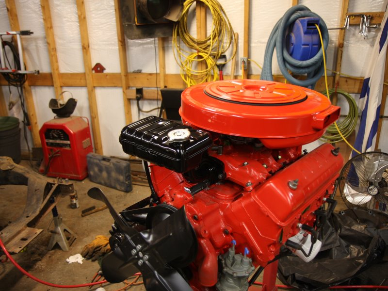

Finished cleaning and sanding the surge tank.
I used JB Weld Steel Stik to fill in some of the dents in the surge tank. Not concours show quality but I was happy with the way it turned out.
Surge tank painted and mounted.

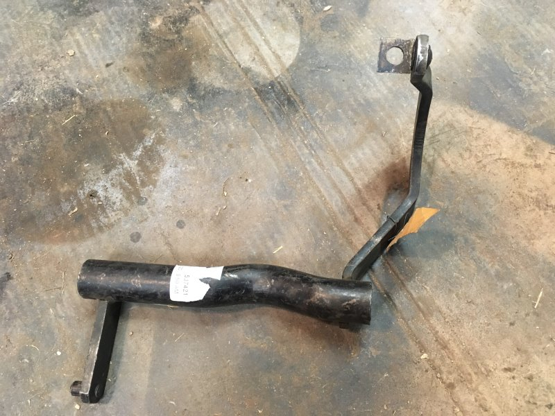

Found a NOS clutch bar.

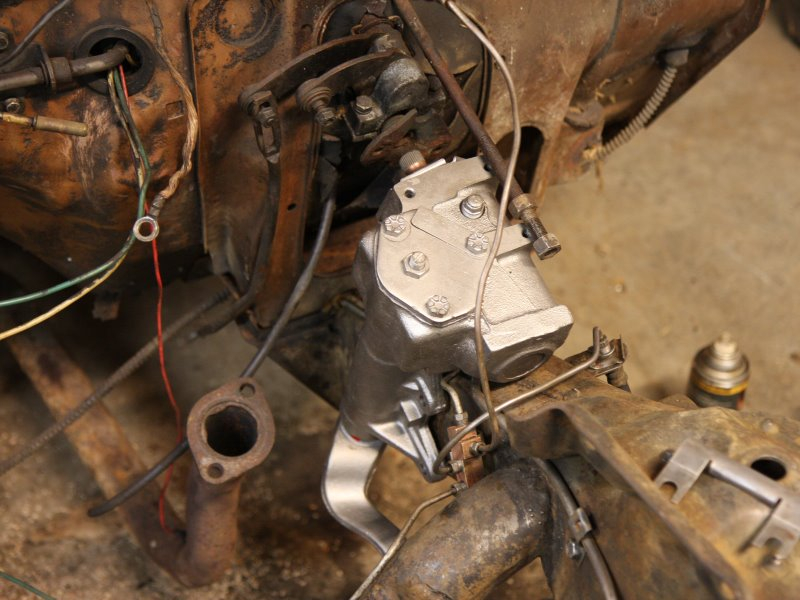

Working on mounting the power steering next.

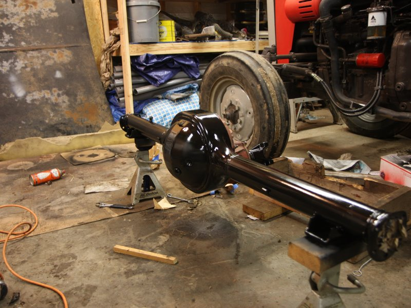

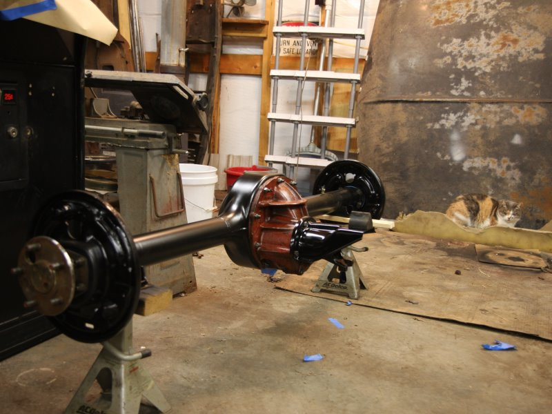

Got the rear end back from the shop. They didn't paint it so I did that.
After I started prepping for paint I discovered that the original Glyptal coating was still mainly intact on the third member. I deviated from my original plan and just cleaned the third member and applied clear coat on it. I think it still looks okay.

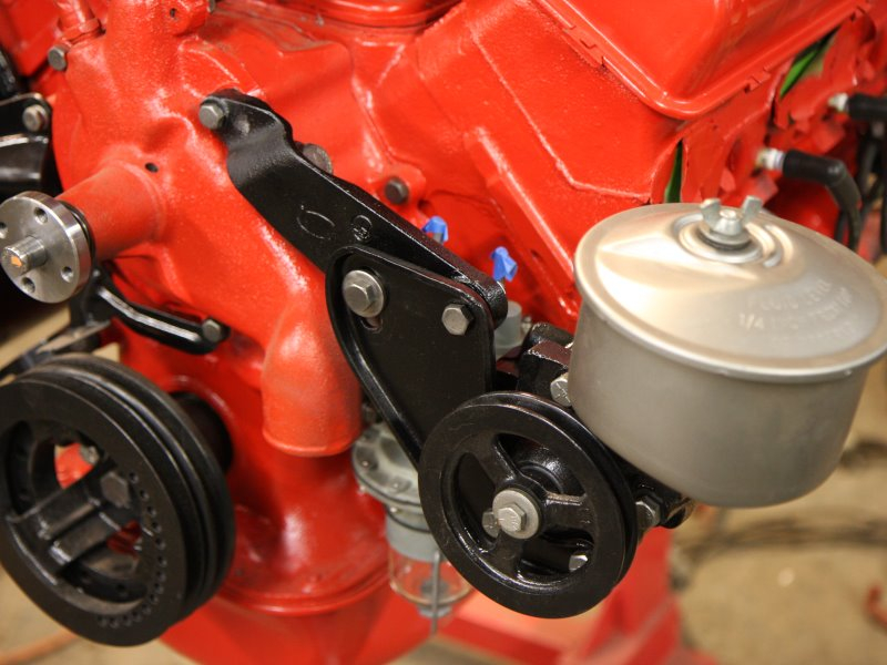

I also painted the power steering brackets and installed the power steering pump.

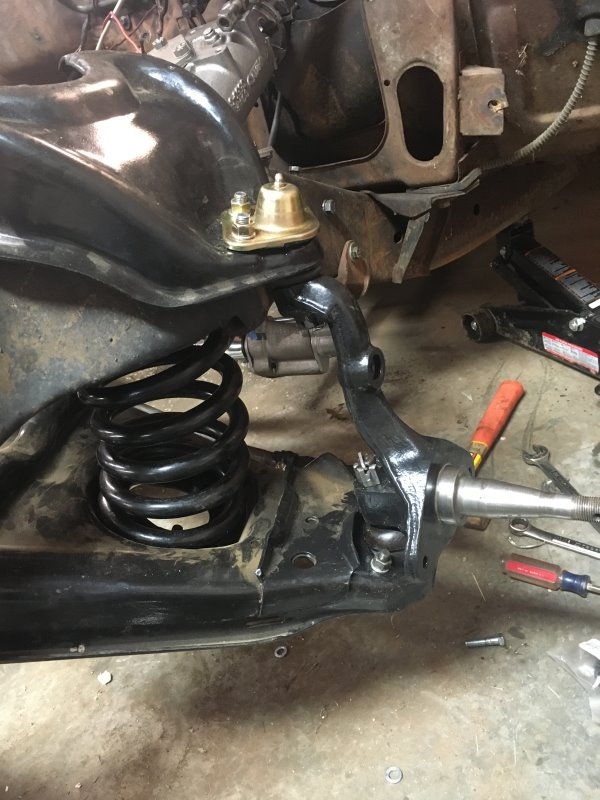

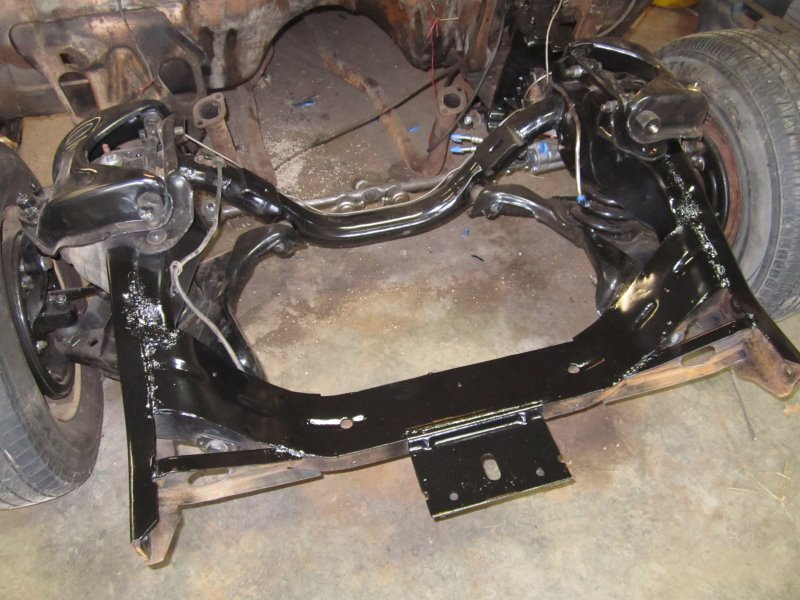

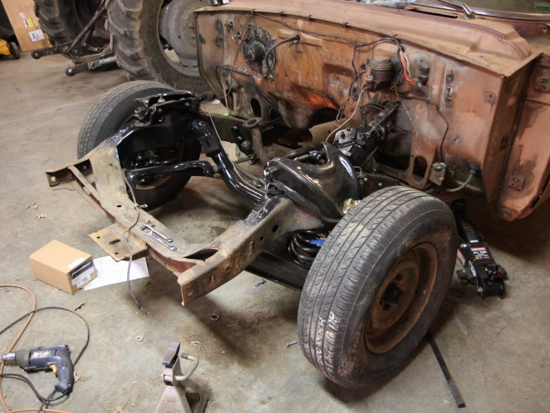

Installed the left side suspension.

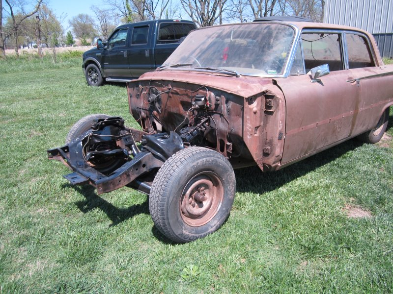

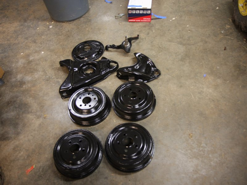

Back on its wheels.
I gave in to project scope creep and decide to clean and paint a little more of the engine bay.

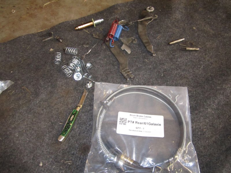

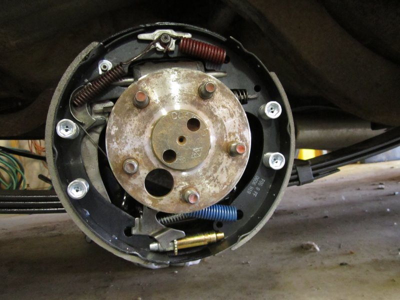

Started installing the rear brakes. Thankfully I was able to send my old parking brake cables to Bruin Brake Cables and they were able to fabricate new ones using the old ones as patterns.

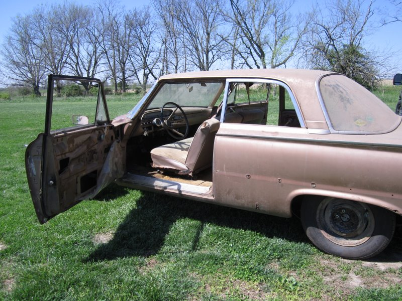

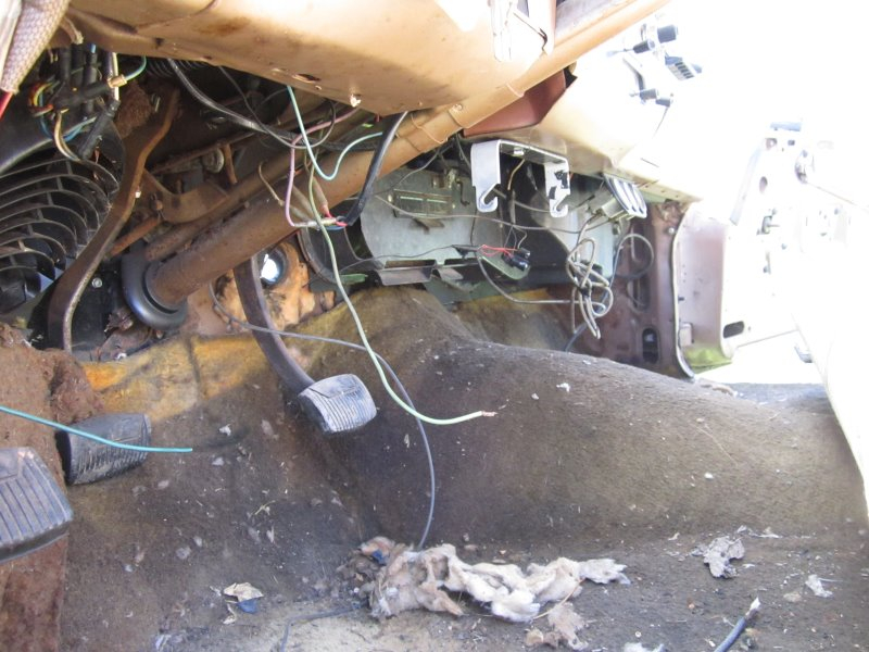

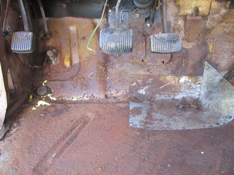

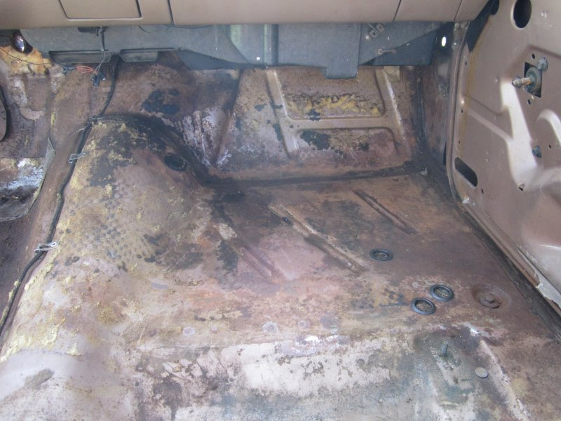

Since the car is back on its wheels I rolled her outside to take out the smelly old carpet.
Found a lot of rust on the driver's side. I was really hoping it wasn't going to be that bad.
However, the passenger side looks pretty good. Strange how the two sides are in such different conditions.

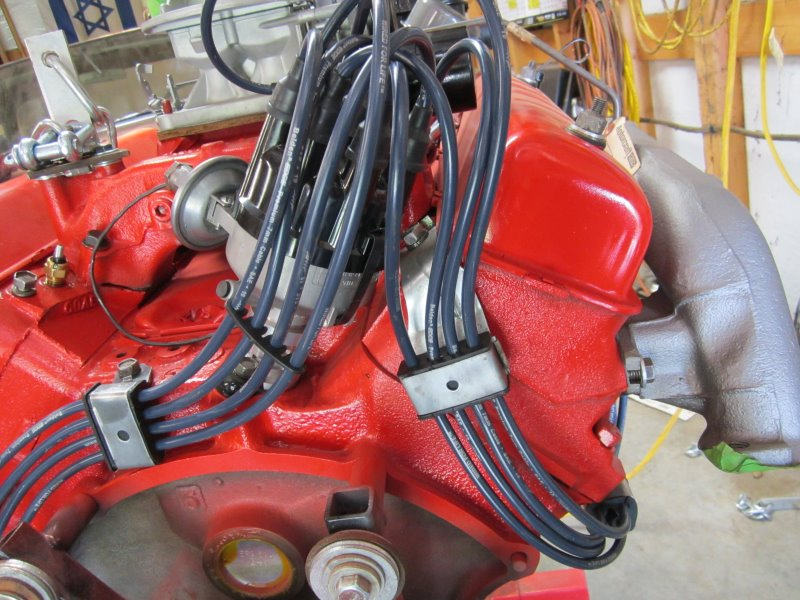

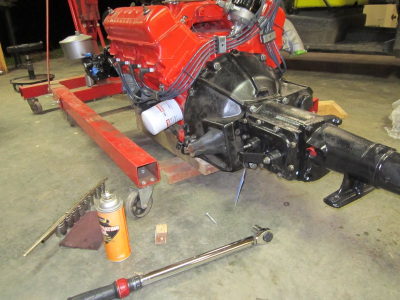

I finally gave up on the universal set of spark plug wires I got from Autozone and purchased a much better set from Napa that was pre-made.

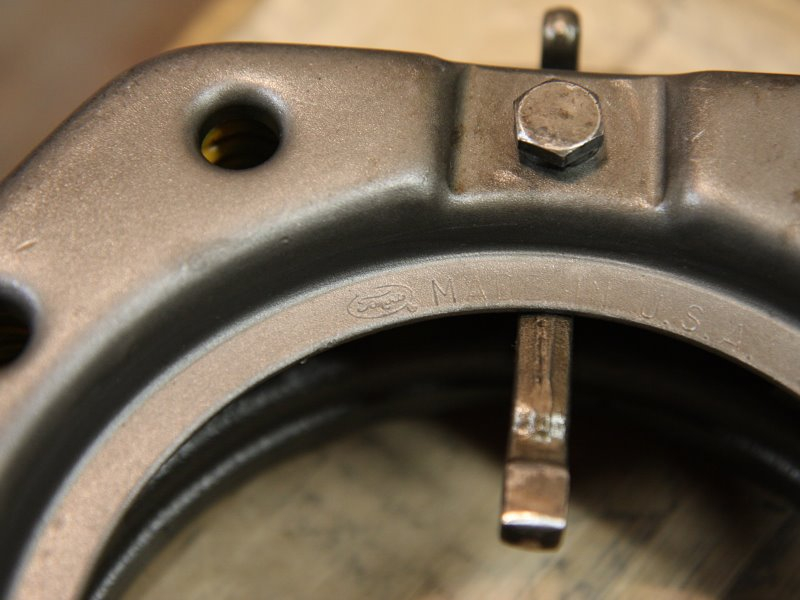

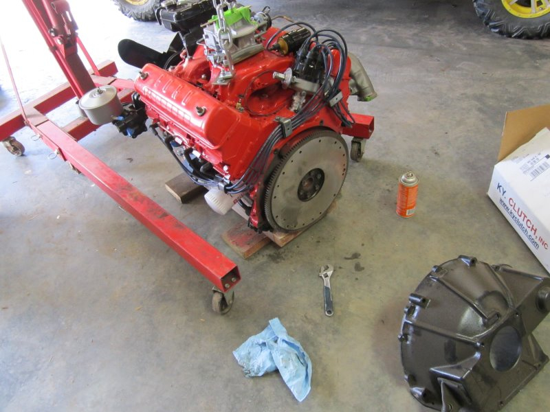

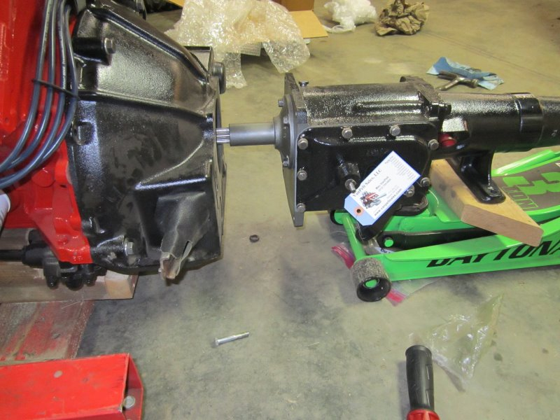

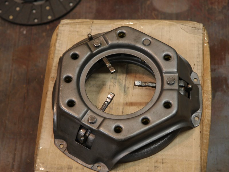

Installed the flywheel.

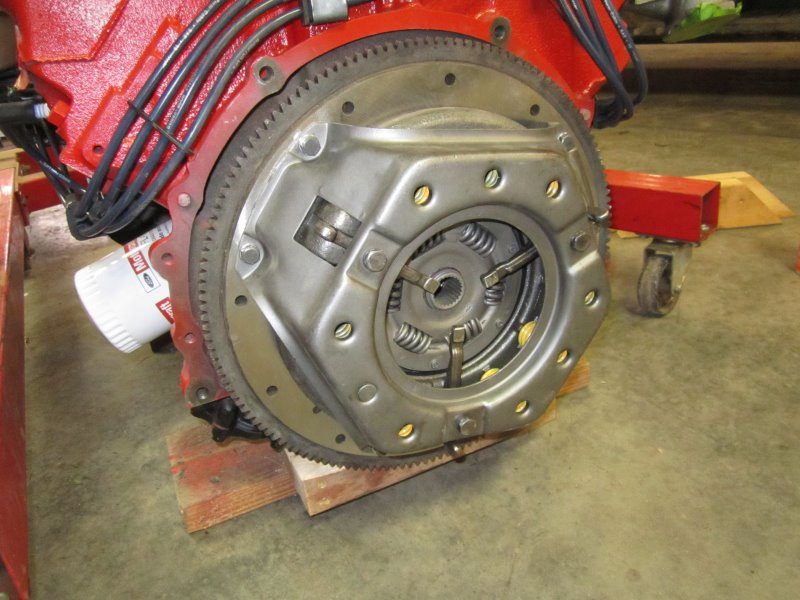

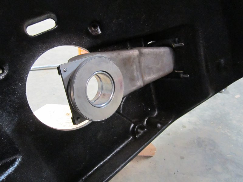

Clutch
Clutch Fork

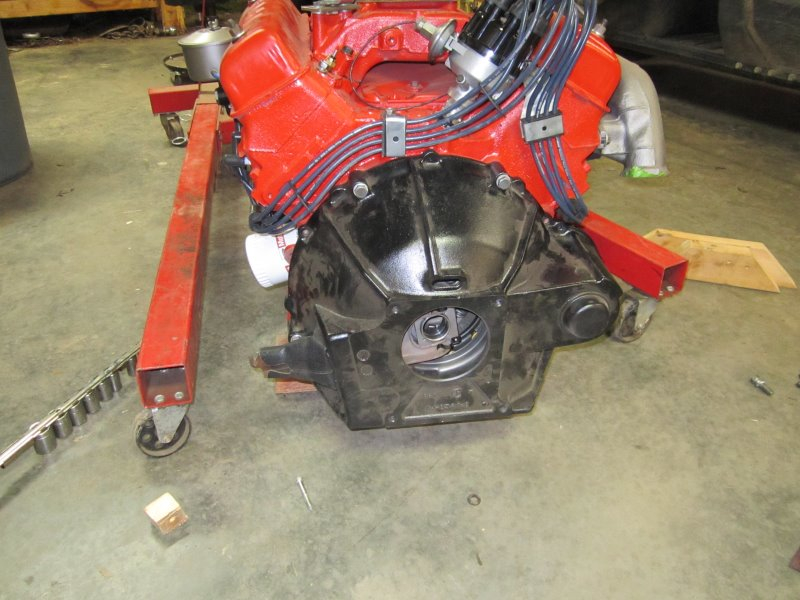

Bellhousing

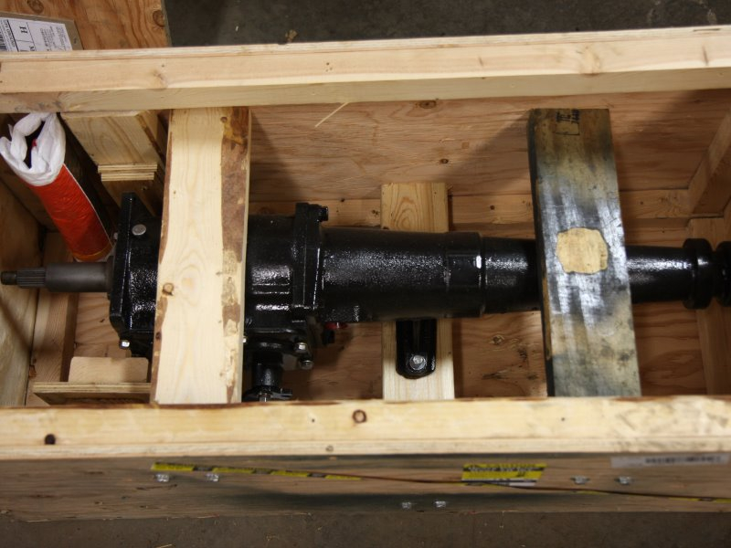

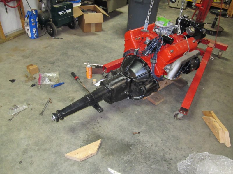

I received the transmission several months ago and I'm now ready to uncrate and install it.

those look like some nice spark plug wire holders, where did you get them??
