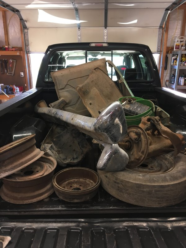

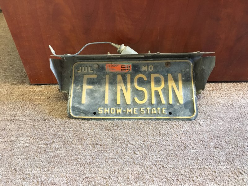

Went through my last storage spot and found my old license plate. I've been looking and looking for it.
Pickup load of items taken from storage.

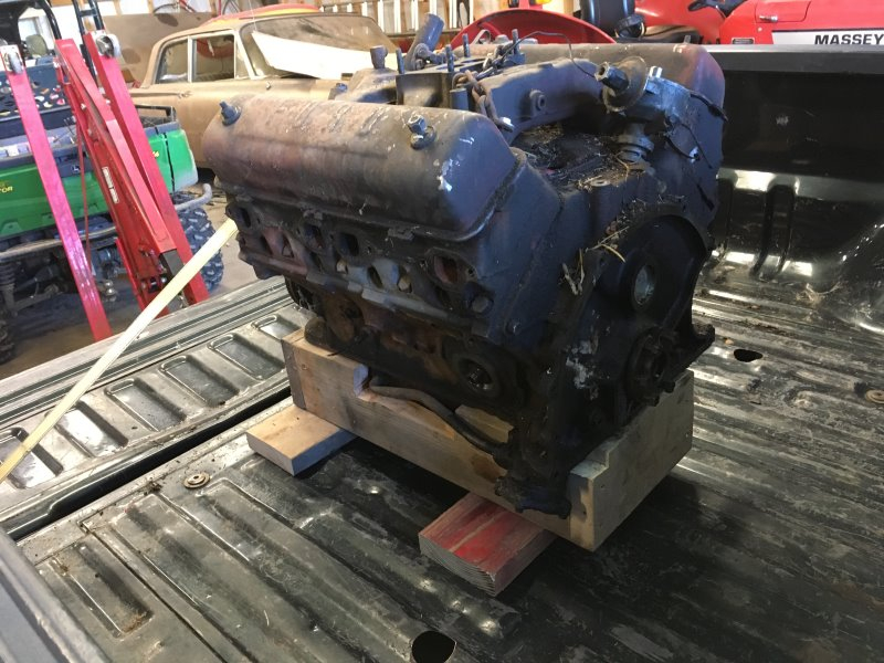

Took the Y Block to the machine shop.

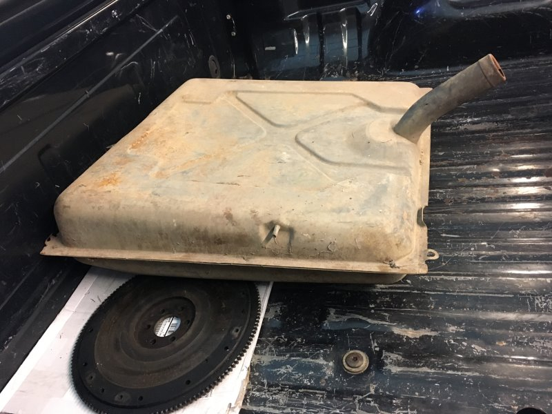

I also found the original gas tank that's been in storage for the last 25 years or so. I took it to be cleaned and lined.

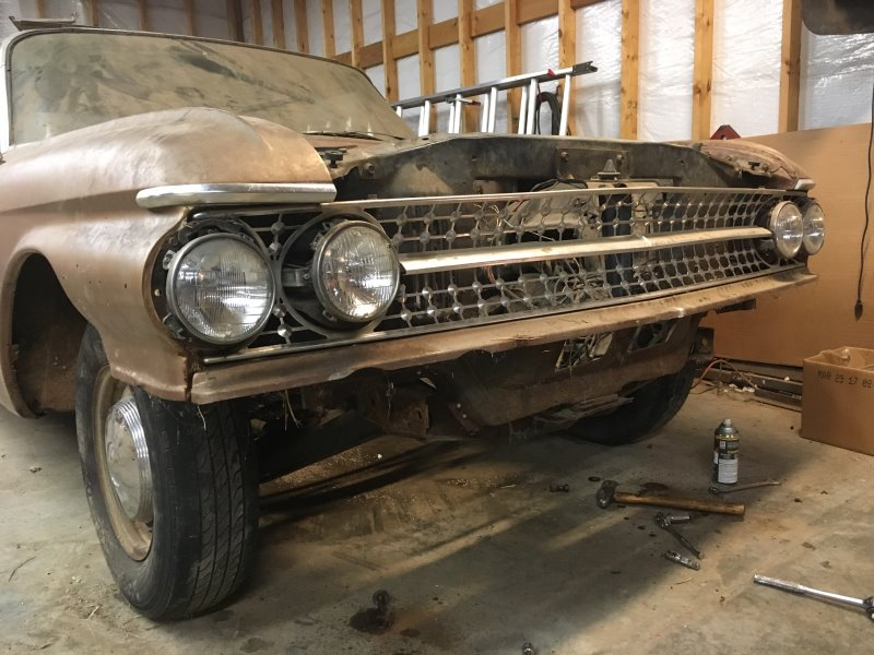

Got the front bumper off.
Hopefully core support and fender this weekend.

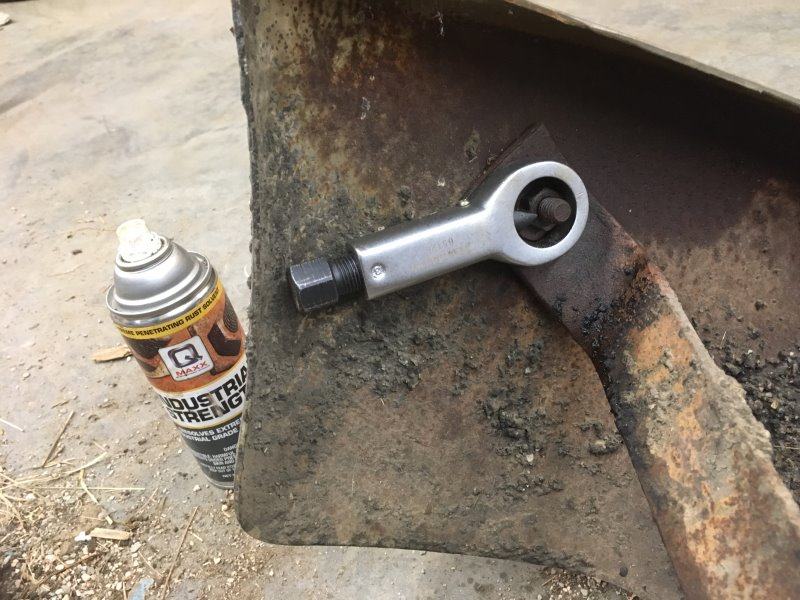

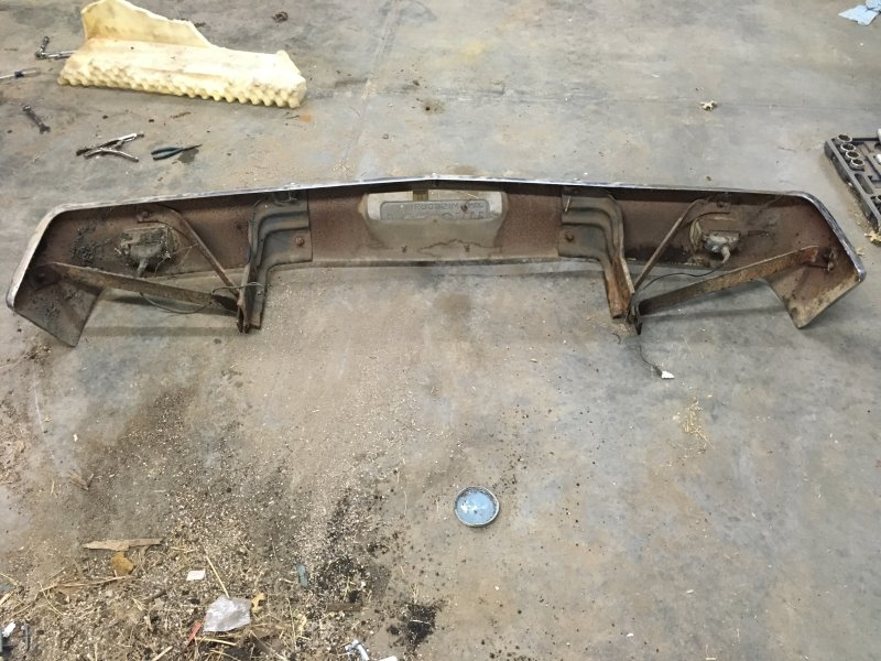

Removed all of the brackets for the front bumper. I used a nut splitter on the stubborn cases instead of a hot wrench to try and salvage the bolts.
Also removed the grill.

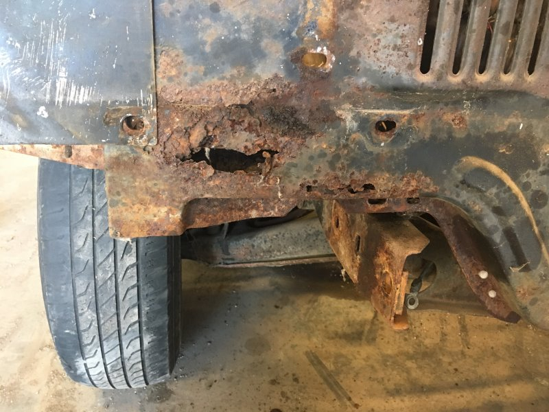

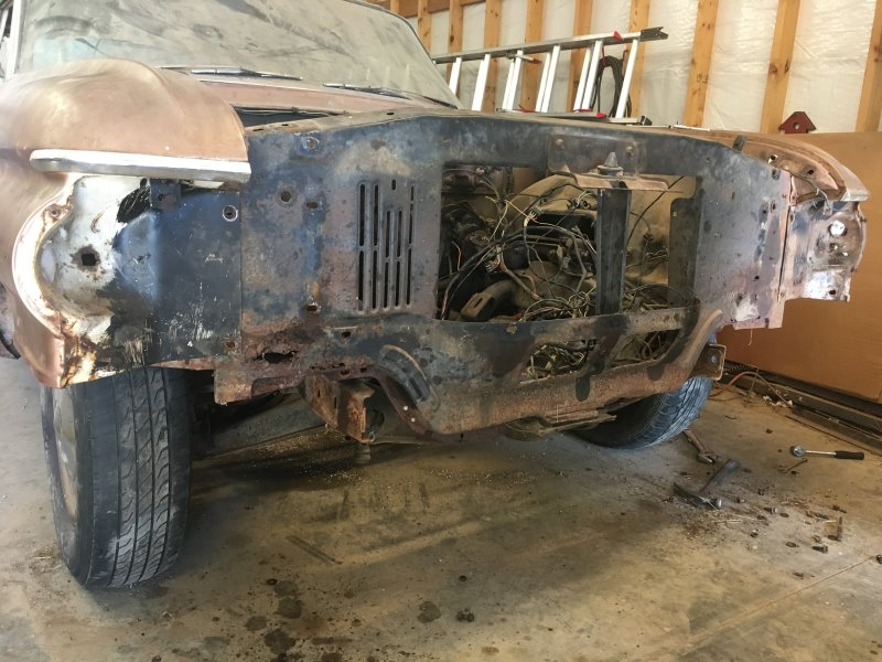

Found some of the dreaded rust in the core support.
Core support and right fender removed.
Now searching for a better core support.

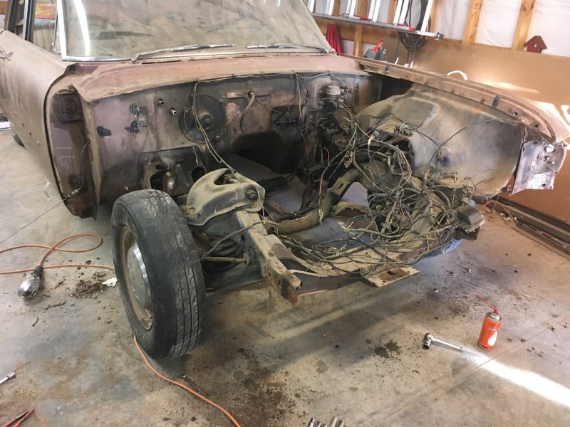

Removing right side suspension.
Does anyone know if the front lower control arm bolt/shaft is removable?

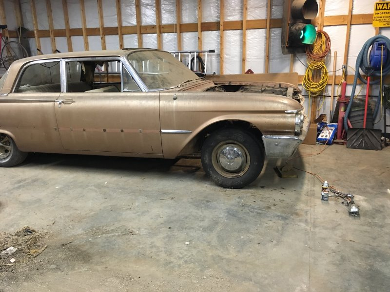

I had the amazing opportunity to tour the private collection of an individual that has been collecting cars for the last 40 years. He has many 60 through 64 Fords, many that are very complete.

yes that bolt is removable but it often times rustsup inside the frame and is hard to get out. Any luck finding a core support?
Offline
I located a core support from California. I have not received it yet. I'll update once I receive it. I'm hoping that it's rust free since it's from a California car.
I'm in the process of trying to purchase the station wagon in the above picture. At this point I'm mainly looking for a complete Y block power steering setup. (I think I've talked myself into power steering). One curious detail on the power steering is that the steering gearbox for power and manual is different according to the interchange books. I wonder how they are different? The ratio?
