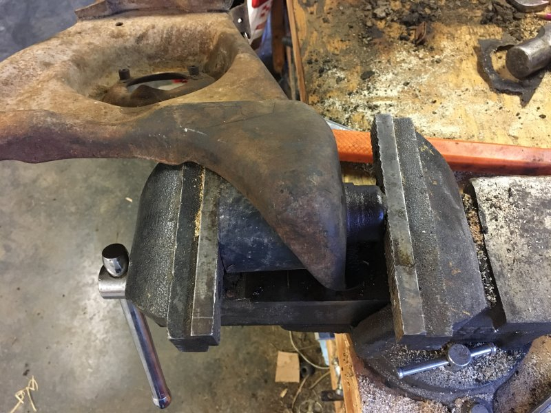

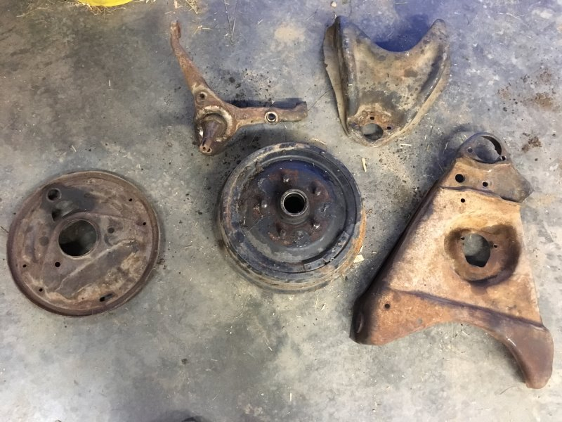

Getting ready to send right side suspension parts to be sandblasted and powder coated. Used my vice as a press to remove old lower control arm bushings.

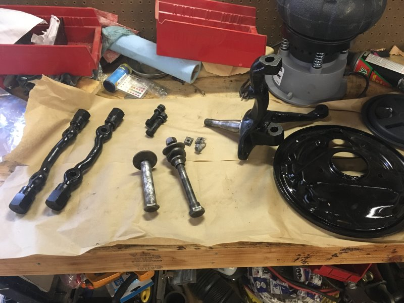

Parts going to sandblaster.

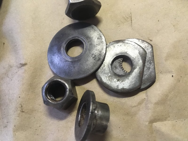

Daze wrote:
yes that bolt is removable but it often times rustsup inside the frame and is hard to get out. Any luck finding a core support?
You weren't kidding about that. I finally manged to remove the bolt but at a cost. I damaged the bushing/washer.
It looks like this is a standard drill bushing with a flat washer welded to it. Does anyone have an extra one of these laying around? If not I'm going to have to find a way to repair this one or make a new one. Mcmaster Carr sells drill bushings this size - 5/8 ID x 7/8 OD by 1/2 long. I would then need to find someone that could weld a SAE flat washer onto it. Can anybody help?

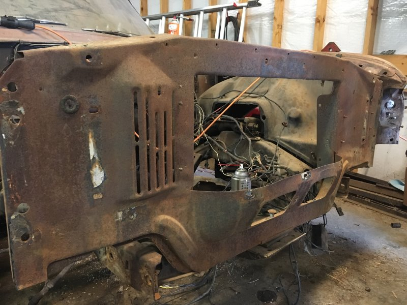

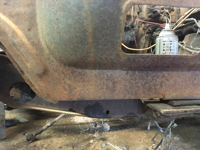

Hoping to get some work done on Memorial Day.
I have received my core support and there are no rust holes.

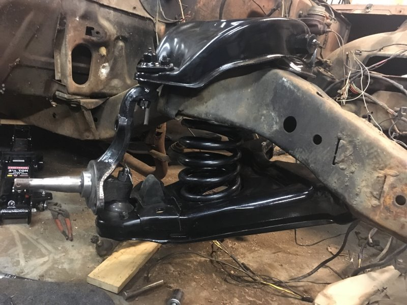

I've gotten busy during the summer so things are moving slowly.
I did get the right-side control arm assembly mounted.

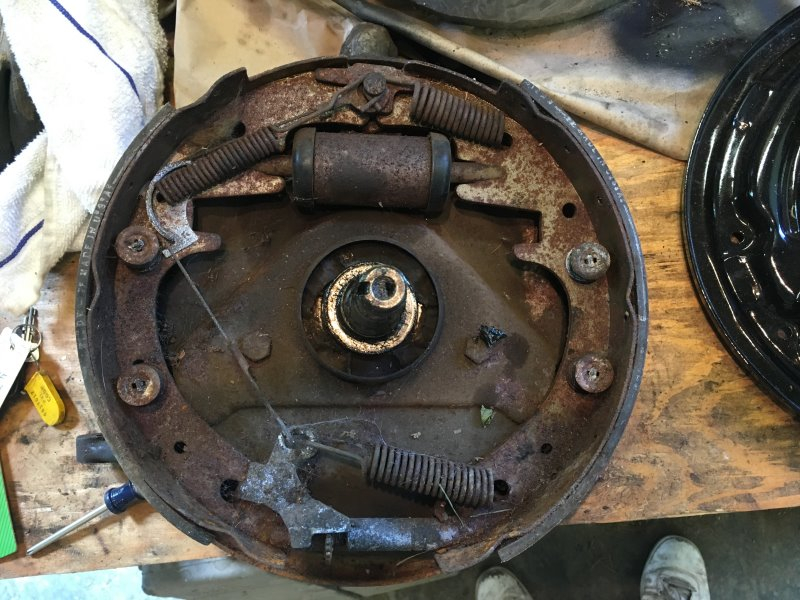

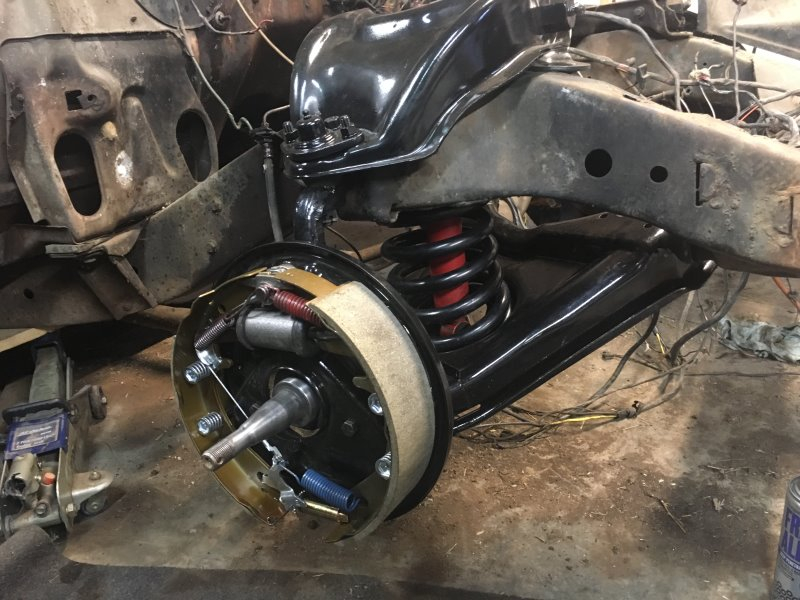

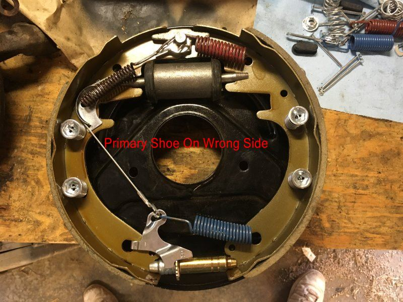

Right side brakes before picture. I didn't realize it at the time but the primary and secondary shoes are installed incorrectly.
New right side brakes ready for installation-note I reinstalled them according to the old ones which is backwards.

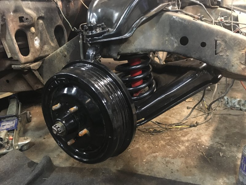

Right side brakes back on car. Ready to put her back on all four wheels!
