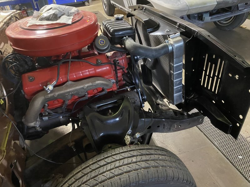

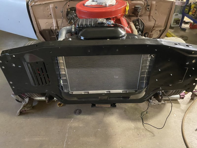

In case anyone was wondering what happened to the Fairlane, I still have it but....
The car restoration shop media blasted and powder coated the core support and inner fenders and painted the firewall.

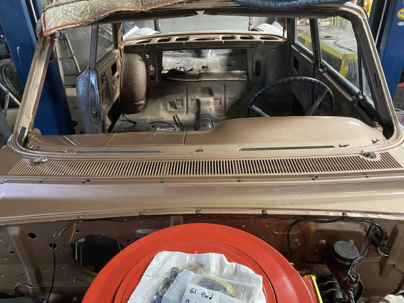

They also removed the windshield and removed and painted the dash.

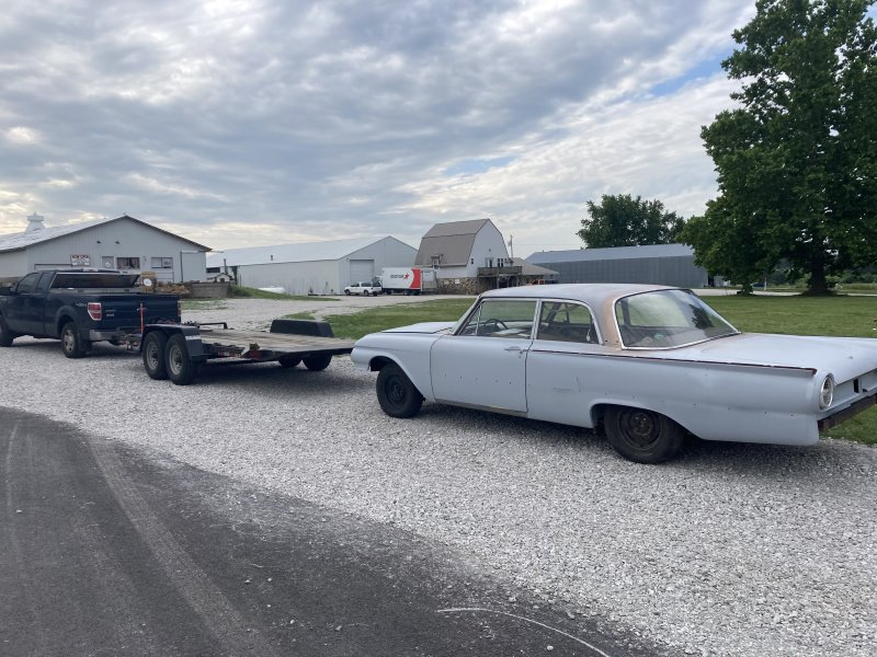

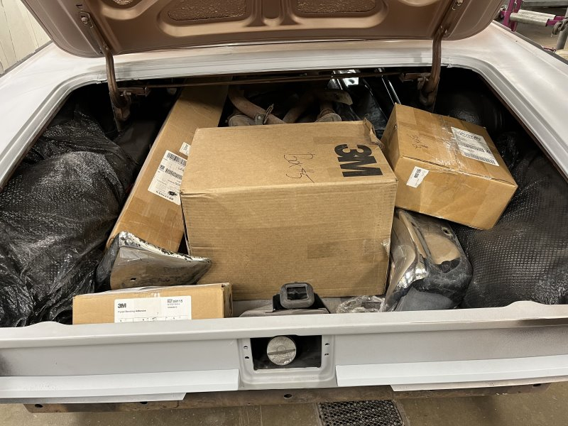

But due to being way over budget and well past the finish date time frame I made the difficult decision to have the car shipped back to me unfinished.  This is what I received.
Loose parts shipped inside the car, some in boxes.
I have to admit it was very disappointing.  Unfortunately from what I understand my story is all too common.

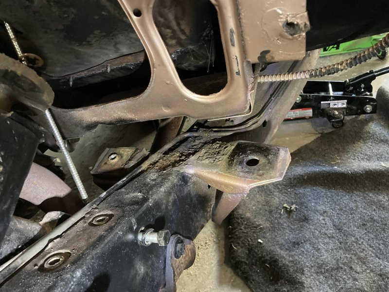

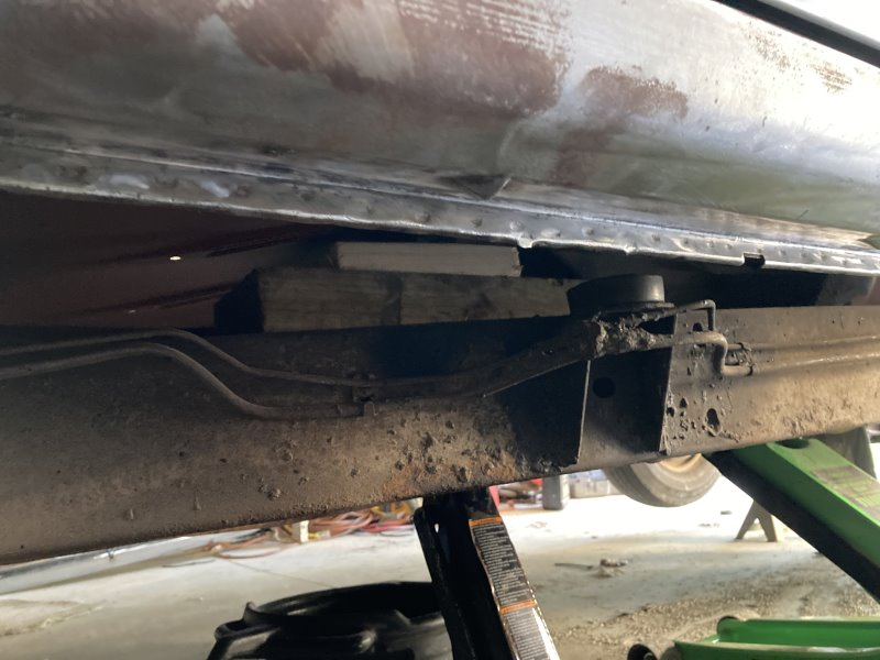

My plan is to try and keep going.  We have moved since the project started and I no longer have a dedicated building.  I do have an extra garage bay so I can still perform some work.  The car was just loosely put together for the trailer ride back.  My first order of business was to get the car running again since it hadn't been started in two years.  I put fuel in and started to crank it over and I had a bad fuel leak coming from the main fuel line that runs the length of the car.  When I inspected the lines I noticed that both the main brake line and fuel line had been cut and spliced with rubber hose.  I can't say I've ever seen a brake line spliced with a rubber hose.  Good thing I didn't actually try and use the brakes.  So, the first order of business is replacing the main brake and fuel lines which requires slightly lifting the body from the frame.

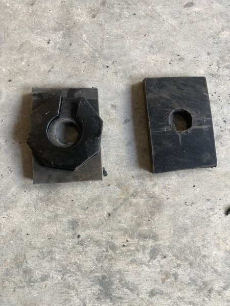

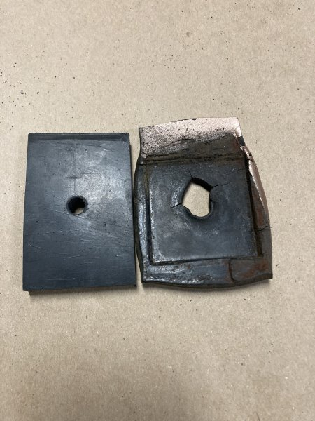

I was able to replace the main fuel and brake lines by lifting the body up on one side.

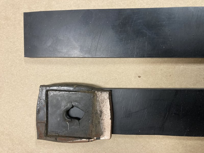

I had to make the new rubber body mounts as there are currently no reproduction ones made for the 1961 cars.
This body mount bushing is located near the rear axle and had a shim on it.

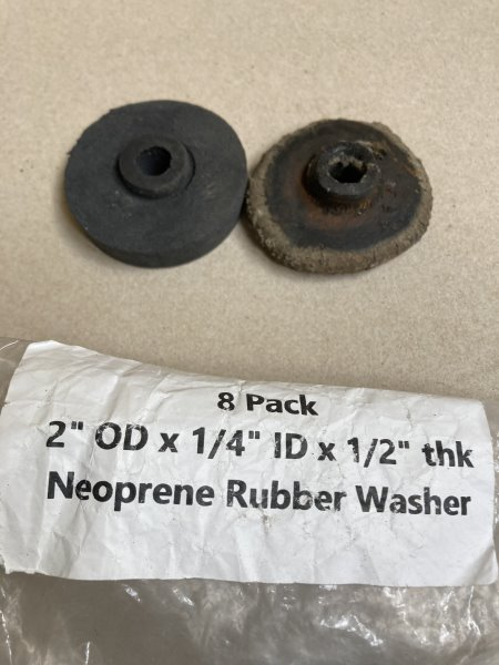

The attaching bolt for the body mount bushings have a rubber washer.  These are not available either so I had to make them.  I bought oversized rubber bushings and then used a hole saw to make the locator part of the bushing and then used a hacksaw and cut the excess material so that I ended up with the correct thickness of washer (3/8').

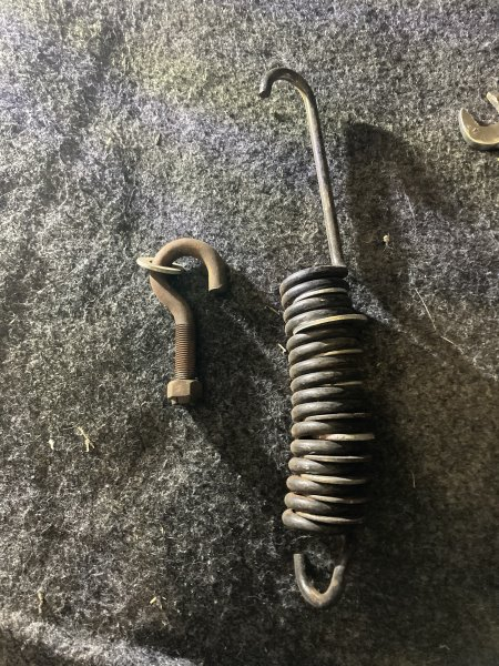

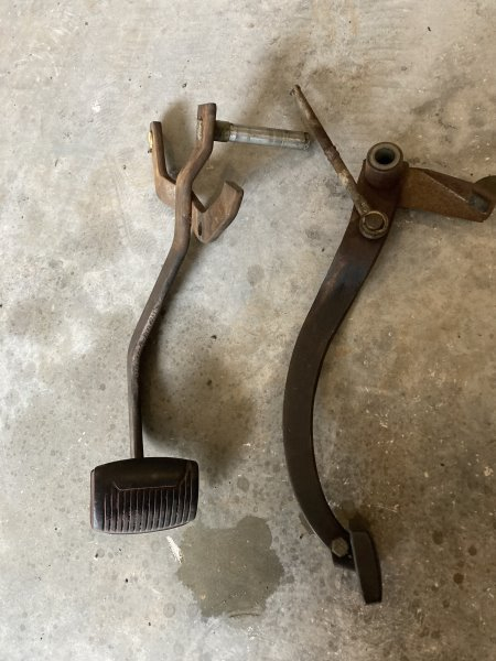

Before hooking the clutch linkage and master cylinder back up I decided to replace the clutch/brake pedal bushings.  I placed washers inside the clutch pedal return spring to relieve enough of the tension to remove the spring.
     Thread Starter
September 8, 2023 8:36 am  #80
Re: 1961 Fairlane 500 Restoration
That washer trick is brilliant.  I will need to file that one away as a good option.
