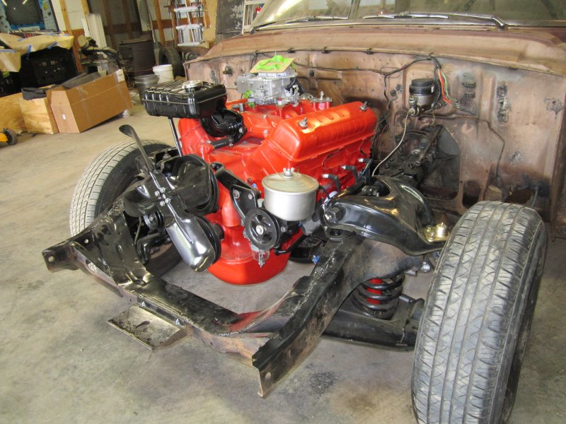

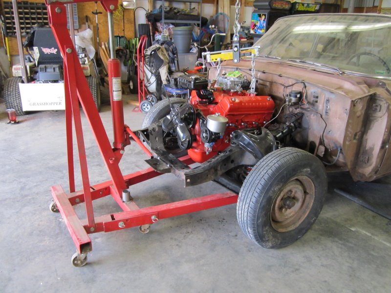

Finally installed the motor into the car.
